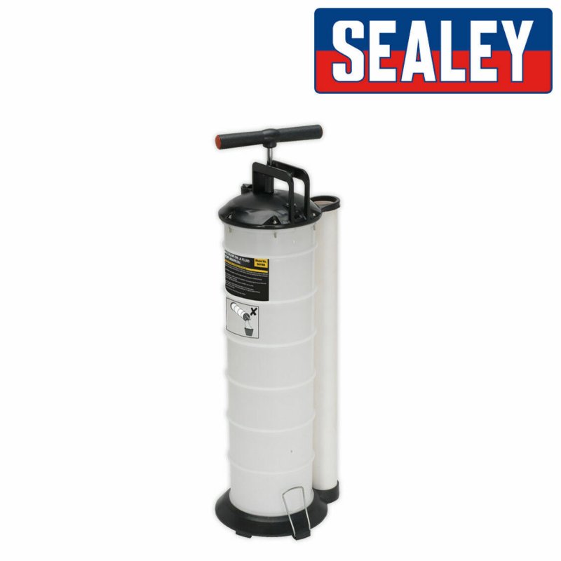

Something like this might do the job, I'm thinking something like screenwash tubing would fit down the dipstick tube ?
Sealey AK54 Oil Suction Syringe 550ml Clear Body Easily remove oil Gearbox Diff 5054511210798 | eBay
  • Thanks 1
Yes. I suddenly remembered earlier today, I've used one before on this gearbox. I think I had put a drop too much in and I sucked a bit out using one of those. Not mine, belonged to a friend. I don't know why I didn't think of it before. I'll see if he still has it before buying one.
This one was more like the tool I used but the same idea.
Thank you for the link and the suggestion :thumbsup:

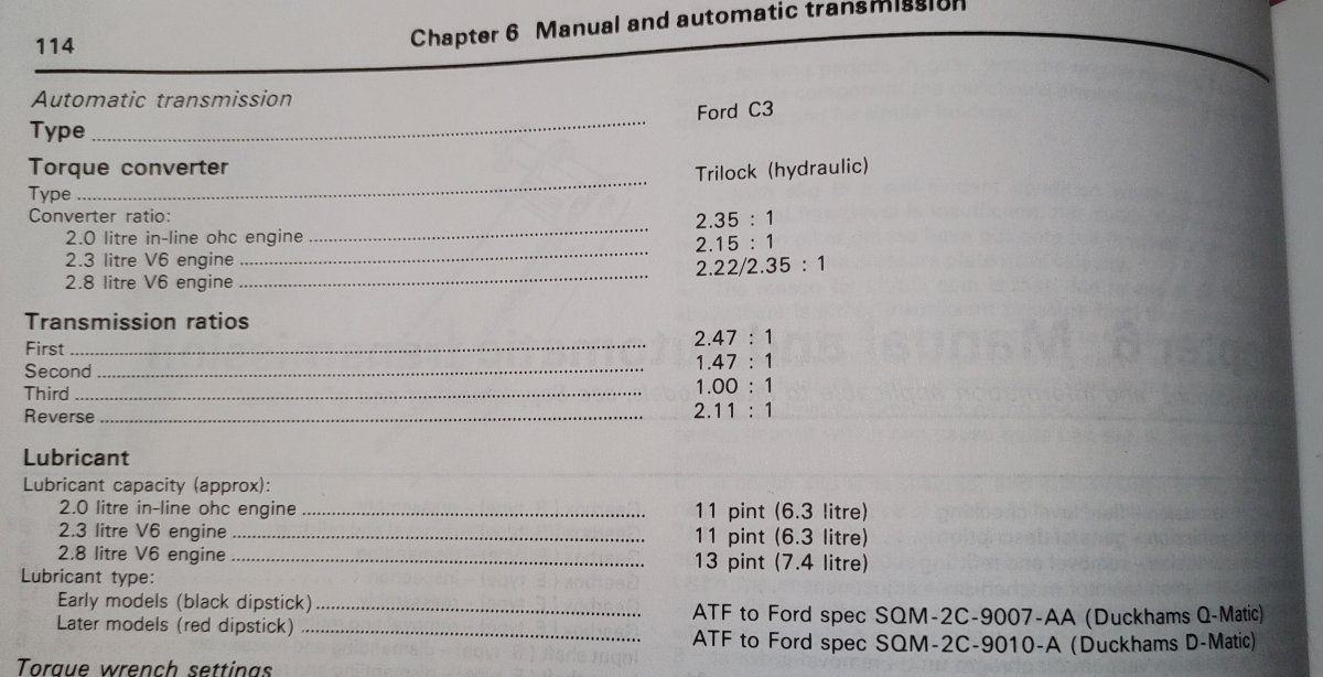

Following on. Can anybody recommend the correct fluid for this gearbox please ?
The dipstick top is red coloured as opposed to black but all the ATF fluid I keep coming across seems to be for Borg Warner boxes.
This is the info out of the Granada Haynes manual
All the oil I looked at seems to match that earlier spec.
Cheers all

I just ask for the red stuff for fords.
The Borg Warner used the same stuff as the ford C3
Cheers Craig.
I was a bit confused as the early dipstick is black and the later one is red. Not sure my local motor factors will have a clue. All the decent ones have packed up.
Imagine walking in to Eurocarparts and asking them for gearbox fluid for a Cortina :rofl:
Do you think this would be suitable ?   Morris ATF
Edited by mk4savage
This stuff 204470149915 dexron 3 etc.
All the rwd fords Inc frogeye , C3,C4,4ald ,etc.
Thanks again Craig.

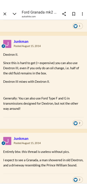

One more question. If the current atf in the gearbox (comma brand) at the moment is a mineral based oil and I drain out as much as I can then re fill with dexron type fluid which I believe is a semi synthetic based oil would I end up with problems do you think ?
I don't know if I'm reading too much into this but I want to make sure before I potentially mix incompatible oils. Cheers
That I don't know, but like you say get as much out as possible .
Ok Craig, thanks again.
I did a bit of googling and some suggest it's ok to mix the two.
One other interesting comment was you can use the mineral type oil for earlier boxes in the later red dipstick gearbox designed for dexron ATF but not the other way around. That's how I interpreted it anyway.
