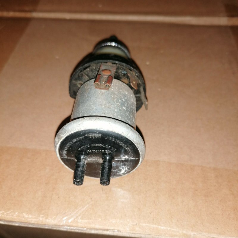

Ok so I have a 1967 New zealand cortina mk2 and i do not have a windscreen washer setup so could anyone tell me if the washer switch is manual ie pump action on thw wiper switch or electric I have just a toggle type switch for the wipers that do not return to the rest position I have to time it is this standard

OK bud , originally it should have a manual pump and switch for the wipers all in one . Someone has modified yours by the description . Steve.

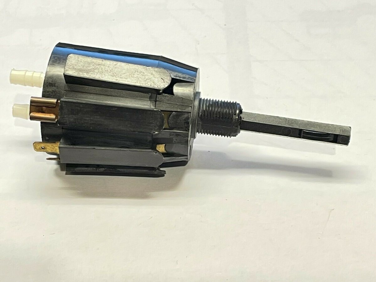

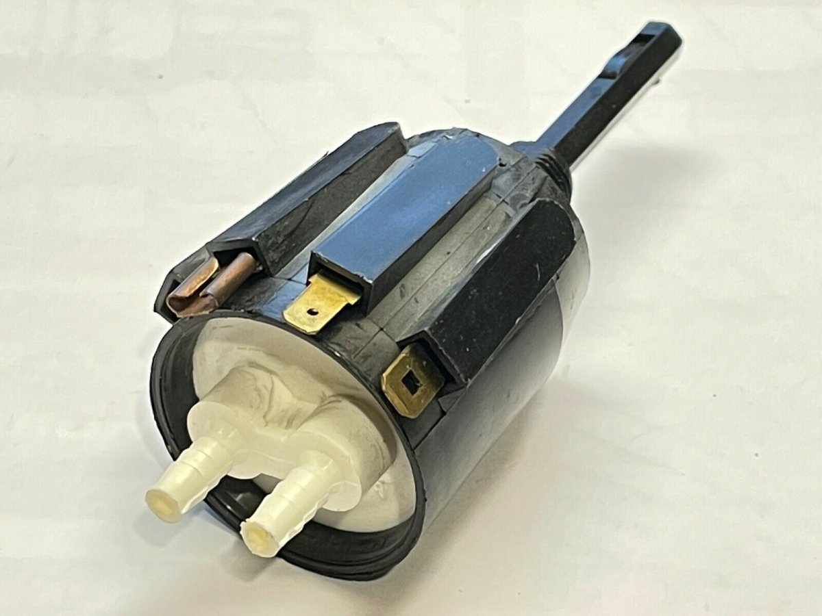

yep, as Steve said. this should be the early type and later ones were full plastic afaik:
Is the Tudor pump that is part of the early version Cortina Mk2 wiper switch also the same as, or usable for, the Zodiac III and Corsair 1500 with variable speed wiper switches? (Phew, I'm out of breath after that sentence!) I''m asking because I have another Corsair 1500 coming. :biggrin::unsure:

The top 2 pics are the same as my 67 Corsair V4, so probably the same. It is two speed wipe, twist the knob, with push the knob vacuum washer. If you go for this you will also need a nrv in the washer bottle pick up pipe end.
