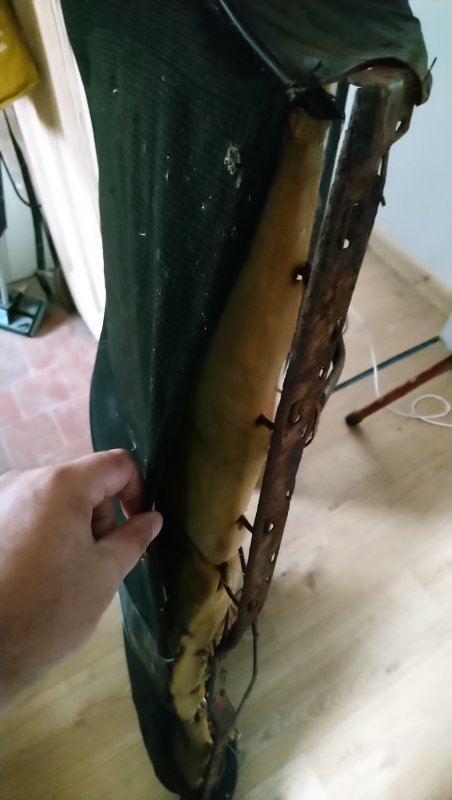

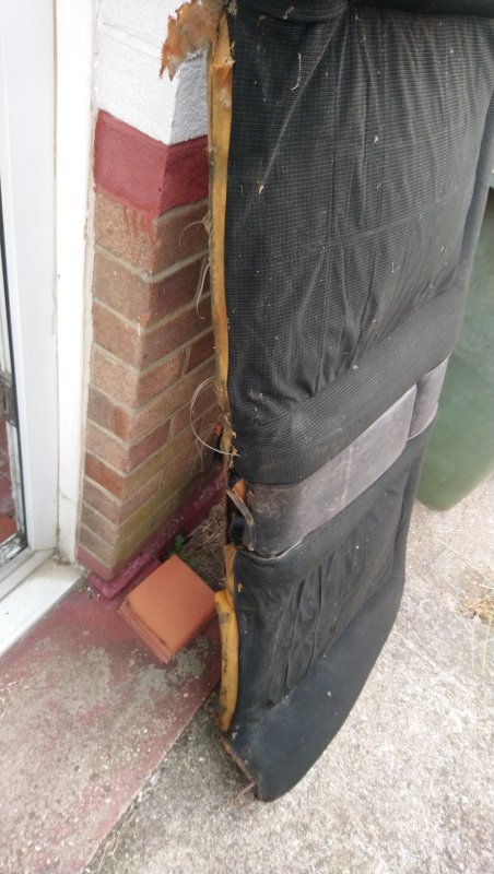

Hi, I scored front and rear mk3 seats for my mk4. They're not mint but waaaaaaaaaay better than the sun-rotted crap that came with my car.
On the rear seat bench and back, the cloth is detached from the frame (at the bottom on the back part, and at the rear on the bench part).
Could anyone share pics of how the fabric is supposed to attach, so I can repair?
Many thanks.

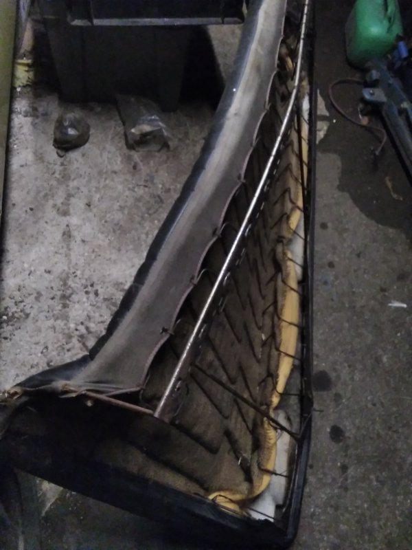

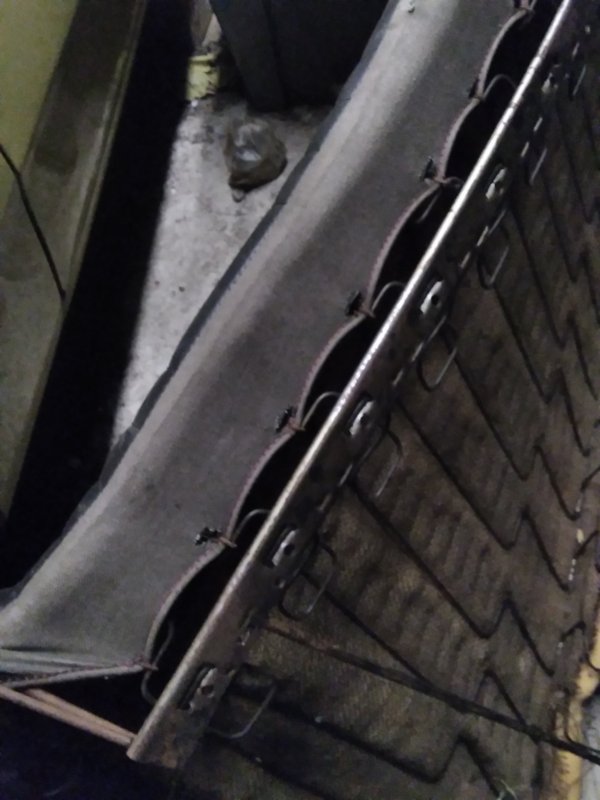

The black cloth should be stitched across the bottom of the seat material ( it splits away over the years an upholsterer should be able to fix a furniture one may be cheaper).
Might have a pic.
Brill, thanks. No worries if you don't, but if you have got a pic of what it should look like, then that would be ace
Here you go a vynil seat but otherwise same
