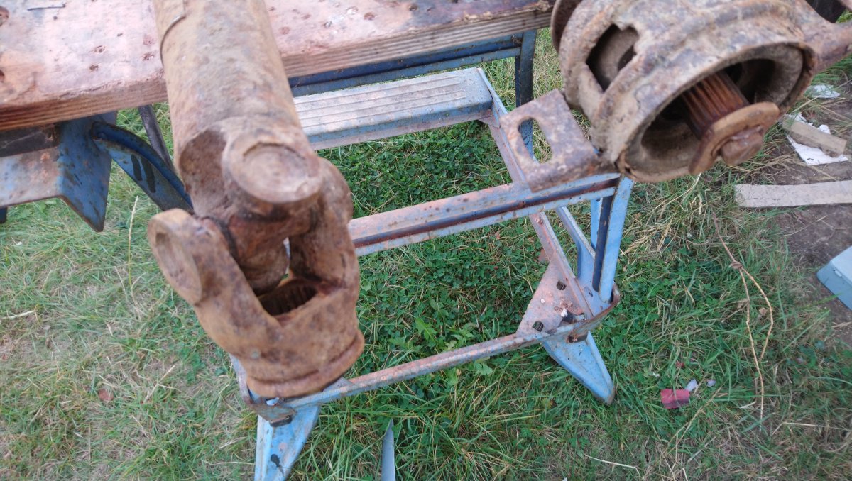

Hi, I got a prop from a 2.0,so that  should be fine.
The seller split it to post.
Are the two pieces balanced independently? So it doesn't really matter how I rejoin them?
Or is it balanced as one whole unit, meaning I really need to get it right?
Thanks
Edited by disco_monkey79
They will only go together in one place through bearing half has a double spline the uj one missing, give both a good clean & a smear of grease for future work.
As said above.
There is a keyway where the splines mate together as it goes into the bearing. Give it all a mega clean up / derust and you should see the gap in the splines.
If your going to put a new bearing on the front half, be wary of the Burton Power ones for Cortinas. These have "ears" that are not level to each other though you can use the rubber bit and seal and just transfer it over on to the old housing.
Also fit the bearing with the red seal to the rear.
