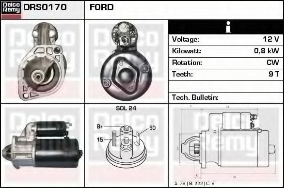

Hi, I have been offered a recon starter motor for my 2.8 v6, but the motor was apparently intended for a 2.3.
I am getting conflicting advice as to whether there was any difference. Some sellers list the same unit for all, some have them as for 2.8 and 2.9,which I thought were different!
Are they all the same? Or did specs change?
Thanks
2.3/2.8 are the same but check if the solenoid has 2  or 1 small terminals.
With points ignition you need the type with 2 small terminals ,with electronic ignition has one small terminals.
All the 2.4/2.9 ones have one small terminals ( as they all have elec in).
Brill, thanks. Will be going with points (at least initially), so that is an excellent point I hadn't considered!
