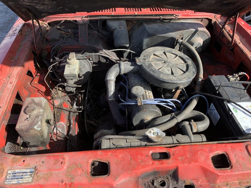

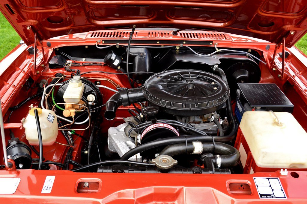

Cortina1975 29 Posted September 8, 2025 On 4/22/2025 at 10:18 PM, sheffieldcortinacentre said: Wouldn't have thought so. Its bolted in along the bottom edge, curl your fingers around the edge. A pair in each corner were the eyeball vents are, then 3 or 4 along top just above glovebox, clocks, heater controls. 10 mm nuts be careful as metal can be very sharp on dash frame. This sorta thing can be a nightmare to find & drive you crazy. Thanks Dr Craig . I managed to cut through some tendons in my hand doing some welding repairs to a Talbot motorhome. . (drilling some sheet that spun) so been out of action for a while .so no progress on the Cortina. Back now and that rattle is still there!. Tightened all the crash pad nuts but no different. I was looking at ebay mk3's and found this 1976 model with what looks like a stiffener between the bulkhead and scuttle panel that mine doesn't have . Could that have been fitted by Uncle Henry to stop the scuttle panel rattle ? . Was thinking of tek screwing something in place but i dont want to start making holes if it doesnt work I Th Quote Share this post Link to post Share on other sites
Cortina1975 29 Posted September 8, 2025 Now i'm totally confused as this mk5 doesn't have the stiffener fitted Quote Share this post Link to post Share on other sites
Cortina1975 29 Posted September 8, 2025 Mk4 has it..can't be a dealer fit piece surely Quote Share this post Link to post Share on other sites
sheffieldcortinacentre 767 Posted September 8, 2025 (edited) It's fitted to some estates for some reason.same for the pieces between inner wing & wing mounting rail. Edited September 8, 2025 by sheffieldcortinacentre 1 Quote Share this post Link to post Share on other sites
