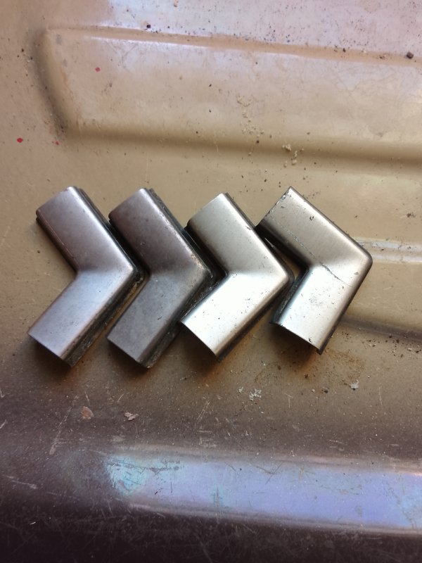

ShortyPaul 0 Posted June 1, 2025 Hi, mine are wide flat type. Quote Share this post Link to post Share on other sites
sheffieldcortinacentre 764 Posted June 1, 2025 Found this set of 4 £10 Inc p&p Quote Share this post Link to post Share on other sites

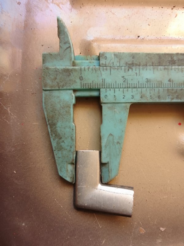

ShortyPaul 0 Posted November 5, 2025 On 5/29/2025 at 2:01 PM, sheffieldcortinacentre said: No there are two different sizes used on mk3-4-5 's you need like for like. Narrow domed type. Wide flat type. I've got some used ones. Quick question, do the chrome corners fit over the fillet or flush up to it? My corners are smaller than the chrome fillet? Quote Share this post Link to post Share on other sites
sheffieldcortinacentre 764 Posted November 5, 2025 Over Quote Share this post Link to post Share on other sites
ShortyPaul 0 Posted November 5, 2025 Right, so my fillet is about 14/15mm did ford fit a smaller one in mk3? my corners may be off a mk3 also if I get some 11mm wide( Escort mk1) will the corners fit over that ad it's narrower? I think the corners I've got may have come off a mk3 cortina but not sure as they measure about 8mm Quote Share this post Link to post Share on other sites
sheffieldcortinacentre 764 Posted November 5, 2025 Far as I know there's just those 2 sizes mk5's used the larger one (possibly late mk4's) ,the Mk5 EST screen/rubber will fit all mk3-4's. I would think MK1 escorts would use the small one as they were in production upto 74. Some late mk2's may have used the wide one. It's a bit hit & miss after all these years. Quote Share this post Link to post Share on other sites
