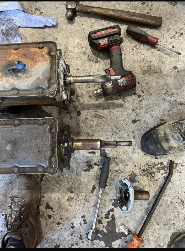

batty3636 3 Posted July 6, 2025 Good mate of mine, has a tiger type kit car with a type 9 fitted to a 2.0 zetec, he's has the shorter input shaft, has another box, can you change input shaft over or has someone got one they want to sell ? In picture, he's is the bottom one Any help would be apreciated thanks Rob Quote Share this post Link to post Share on other sites
batty3636 3 Posted July 6, 2025 Sorry Grearbox's pictured, its the top one that come out of the kit car with the flange removed Quote Share this post Link to post Share on other sites
sheffieldcortinacentre 767 Posted July 6, 2025 Bottom one will be a V6 or diesel box, you can swap shafts but both boxes will have to be completely striped as shaft is fitted from inside. If he's going to use original 4 cylinder box he'll be fine, if he's going to use replacement bottles he needs to find out what it's from as diesel has terrible ratios for a petrol eng, he'll probably get away with V6 one being a kit car. Diesel bellhousing looks like a longer 4 cylinder one , V6 the top pair of bolt holes stick up on a lug ( so don't form a circle. Quote Share this post Link to post Share on other sites
batty3636 3 Posted July 6, 2025 Thanks for taking the time to reply, ill pass that all on to my friend, so he's best bet really is either to get his old box rebuilt, or try and buy a replacement, thanks Rob Quote Share this post Link to post Share on other sites
sheffieldcortinacentre 767 Posted July 6, 2025 Really yes ,he needs another from an ohc or cvh 4 cylinder. Quote Share this post Link to post Share on other sites
