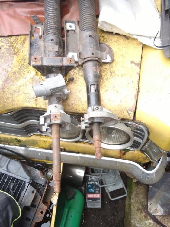

Only way I can show you is if I find & photograph the columns ( I'm no good at computer stuff.) I'll get some pics tomorrow.
The MK3 wheels are slightly oval & a little bigger.
The plastic tube/extension is to hide the longer shaft ( the outer tube that carries lock & stalks is the same length).
I have a facelift column in my prefacelift  MK3 racing car so I can have the  controls on the column instead of on dashboard ( which was all removed) so I can reach them while wearing racing harness seat belts.
Here you go longer MK4/5 column on left , shorter  MK3 on right.IMG_2025-07-22-15-52-18-248.thumb.jpg.bd983e4517c2ce79430eb1668e02d8a2.jpg

 Yeah i see now thank you so much for the picture :smile:
Thats quite a lot of difference in length as well, i guess i wont buy the wheel for now. Maybe yeeears later i ll swap the column together with the steering wheel.

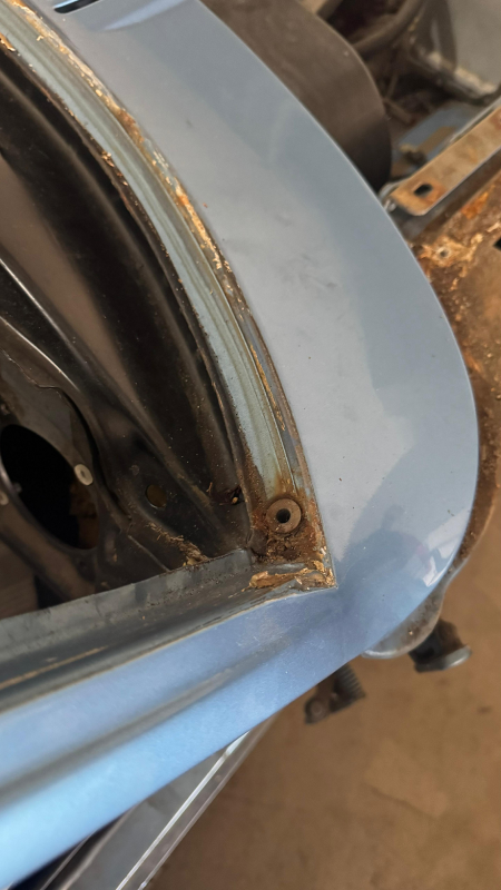

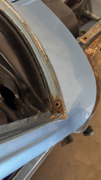

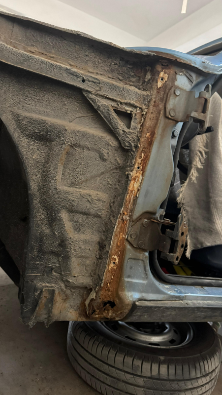

Also actually the cowl is already cut off, remember when i made a post about my car leaking water from a rust hole under the cowl piece. Its still at the bodyshop and the cowl was cut off and the rust was repaired. Currently its being put together i hope it ll be back in a couple of weeks. Pictures below from when they took off the stuff and found the rusted out sections, dont have a picture of it but afterwards they also cut that cowl piece to repair the rust underneath it where it leaked water from.
image.thumb.png.ce500755a41514e4a74be396aa935aa5.pngimage.thumb.png.c81166cf440e0aef3d2a41f0ae4d003b.pngimage.thumb.png.46d43e256d929e8595f269d71e0774ad.png
Edited by Dinoplex
That's a very common rust spot on them.
If you look inside the hatch the holes are there on the inner frame for the earlier handle.the clocks in the TC2 are just plain if there's no time clock, I think they were trying to get away from the old style badging in the second half of the 70's..

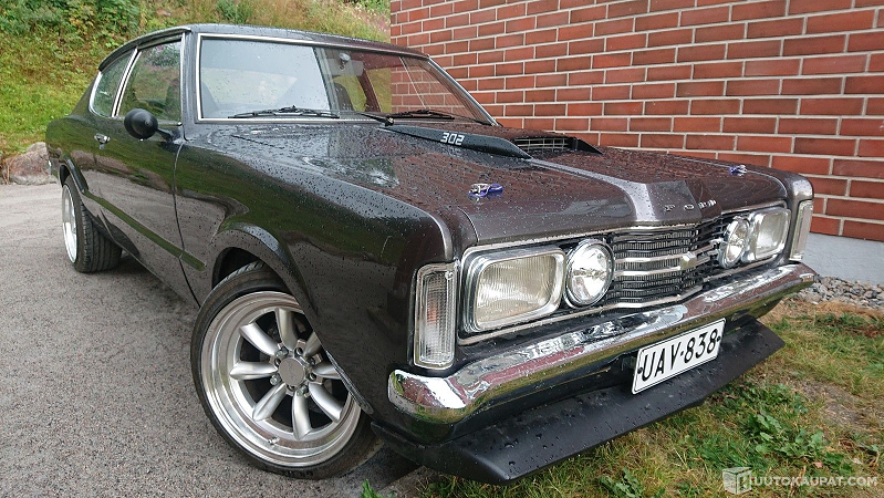

Yeah looks like they tried to get rid of that 70s flare/charm idk how to call it exactly :biggrin:. I love the first half of 70s styling both on taunus/cortina and granada, they look so much better than the later models imo and i also love the earlier logos and badges.

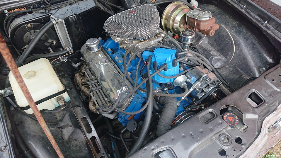

In my 72 MK3 the Windsor with a normal height weiend manifold & 4 barrel carb the air filter just rubs on the hood. I run a foxbody Mustang T5 manual it's virtually the same size as the original box.
I run a MK3 transit radiator with mechanical fan  it runs about 1/3 of way up temp gauge ( done over 10,000 miles) but over heats in traffic as heat can't escape from underhood ( no problem with hood removed lol. It is very cramped in engine bay).
I've now built a cowl induction hood ( raised centre like quite a few muscle cars) I have an 8 inch fan in it that sucks hot air out of engine bay & blows it towards windscreen.
Not had chance to try it yet but should work.
I hate doing bodywork ( filling/sanding etc) but enjoy the welding, mechanical jobs.
Ah i see, did that minimal rubbing on the hood create any issues before you went to the bulged hood. Since the underside of the engine bay is fully open i thought it would allow enough area for hot air to escape from, never thought that would normally be an issue until now :biggrin:. I wonder if an alu radiator together with an extra electrical fan would be enough to force out a bit more air out the engine bay and prevent it from overheating. With the cowl setup blowing the hot air towards the windshield, wouldnt that heat up the cabin a bit by blowing hot air also thru the cowl openings. There is this guy in Finland that did this 302 windsor swap in his TC1 and it also looks pretty nice but he also put a bulged out section in the center of the hood and uses that as the intake for the carb and moved the radiator a bit more up front towards the grill. Dont know anything about his specs tho. In his picture it still kinda looks like the v8 isnt tooo crammed in there, seems to have even more leftover space compared to a 1st gen plymouth barracuda with the v8 where chrysler shoehorned their small block into it despite the cuda being based on the valiant which was never designed to have the v8 so it was a very tight fit, it was so tight of a fit that even just log style exhaust manifolds barely fit in it.
What kinda exhaust manifold are you using, is there enough space for good 4-1 or 4-2-1 style headers , not sure what this finnish guy is running and it kinda looks like there is some space left there for good manifolds but im not sure :smile:. Also i ve heard of putting mustang 2 axles at the back to handle the v8s, are you running the stock axle or something else and roughly how much net power do you think it puts out at the crank. I think Michael from the video above in my previous message will run the stock köln v6 axle since his windsor will not make that much more power and torque in malaise era configuration.

I have 4-2-1 headers, the rad has an aluminium core & have tried twin fans.
It was only a problem when stuck in traffic . Probably having spacers to raise the rear of the hood would have been enough, the problem was airflow through the engine bay not through the rad.
I only need the extractor for a few minutes so don't think it will be a problem with it heating the interior, as the engine temp even with normal hood soon got back to normal.
