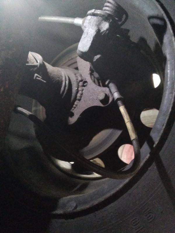

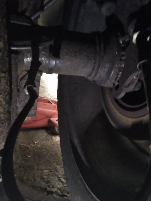

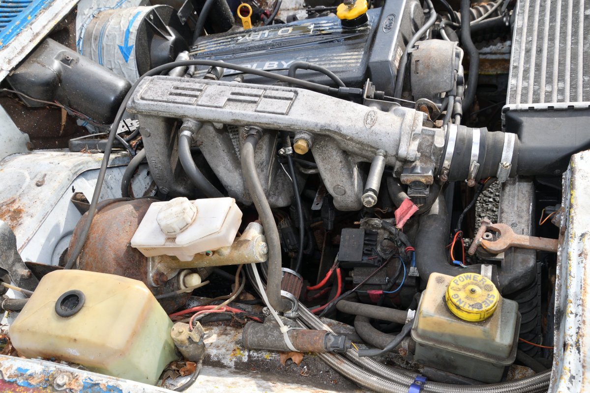

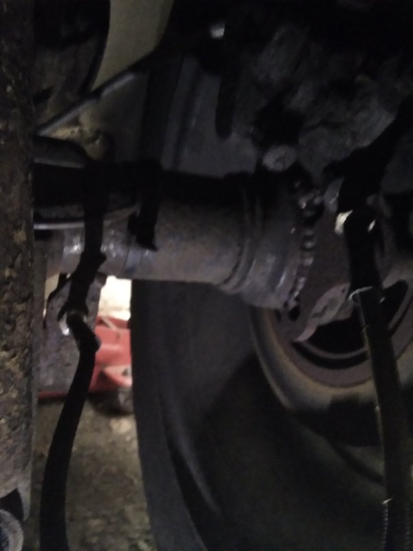

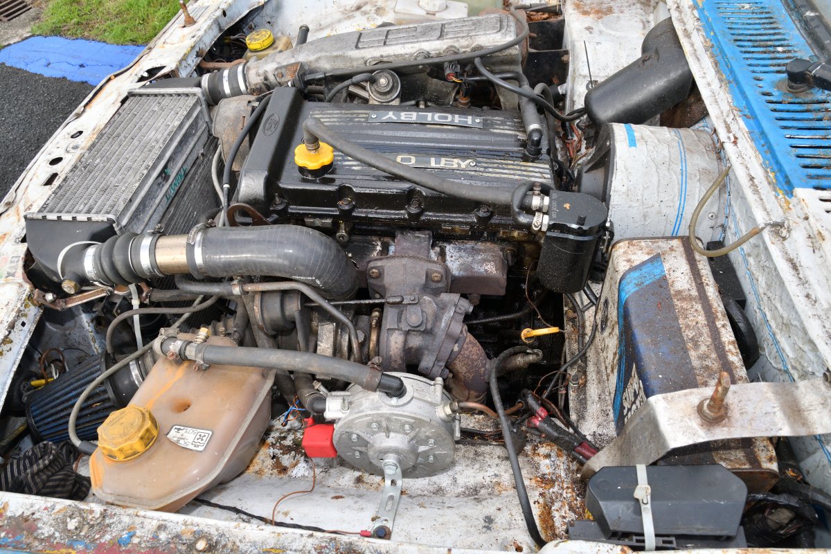

I use the same setup on my 2.0 turbo MK3  track day car.AAE_4255.thumb.JPG.44d28e1c6088f2b16be35bfd13b769e4.JPG
AAE_4262.thumb.JPG.5444289a24a18369f8cfb790dc2e0751.JPGAAE_4259.thumb.JPG.2e6976dbd55b696c0b92ab96f28b9020.JPGAAE_4281.thumb.JPG.a6e03b3485a03aca5b377ce9a7ee4a8c.JPG
Hopefully pics enclosed.IMG_20240516_183801.thumb.jpg.6eff046f4734d8a25ef9047756ee1c9f.jpgIMG_20240516_183609.thumb.jpg.59ae60123d22f3e10dce617dae691267.jpgIMG_20240516_183809.thumb.jpg.be8e36ef5f782137fb154b27d943d731.jpg

It's just for fun it wouldn't meet regulations to compete,  std setup will easily cope with 150 hp.
This set up is geared towards combating brake fade from repeated heavy stopping. There's a full article in retro ford on it a couple of years go.its laid up for winter now .IMG_20240913_023323.thumb.jpg.ccc4ce079740e1acd197a8ec8e9b8369.jpg
