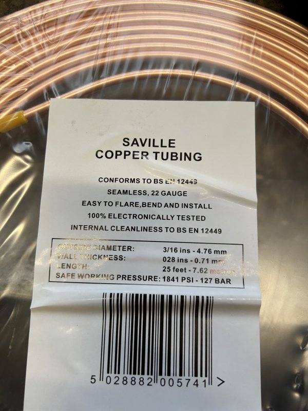

John Mack 337 Posted December 17, 2025 Here’s my copper pipe, got kunifer somewhere but can’t find it. Quote Share this post Link to post Share on other sites
