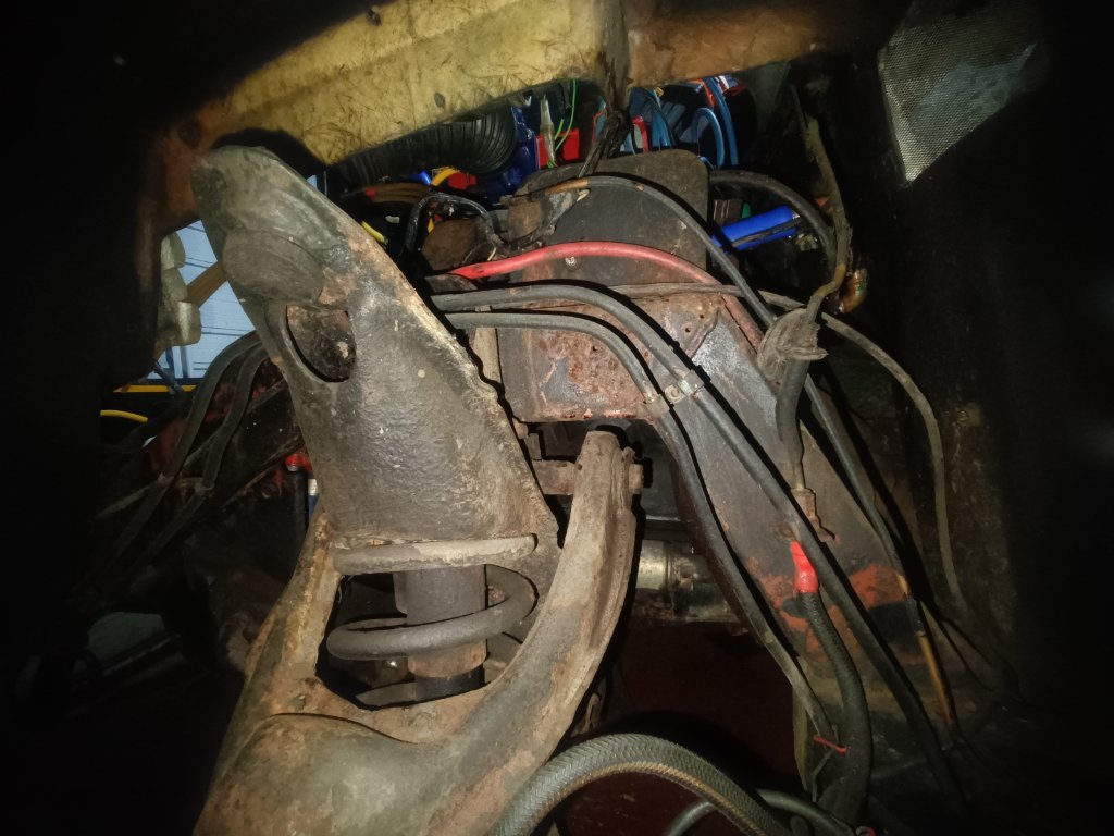

Craig question - If what I see from the photo of the front chassis/Cortina cradle on that Eagle wouldn't it (in theory) be possible to space out the top of the cradle?  That way moving the upper arms outwards offsetting the negative camber effect of the lowering?  I seem to remember somewhere in the vague depths of my mind a similar issue when swapping cradles between different marks of Cortina (later versions into prefacelift Mk3 or something like that??) or am I really going mad in my old age!
If that might work perhaps @Daveyboy20 could take a photo and explain exactly how the upper part of the cradle is attached to those big square chassis rails

I know what you mean, but no as the upper wishbone bolt goes through a tube which is welded into/through cradle , lower is two bolt holes.( American GM 60/70s double wishbone stuff can be adjusted like you say with shims on upper arm).
Unfortunately You can't alter the camber without modification or adjustable arms ( caterhams etc do this but I don't think those will fit as they only used to use the stub axle )easiest (also free) is redrilling the lower arm cradle mount holes ,.
n the 90s I did one with slots instead of holes, & used some of those serrated plates off the rear axle lower mounts so it would  lock adjustment in place & put some marks at 5mm increments ( eat your heart out escort boys) ,you can alter the caster via the tie bar that goes between lower arm & front of cradle. It's the only std adjustment possible ( except tracking).
The front cradle could be moved up/down to alter ride height but it while raise eng/box thus altering drive line angle.

I'll be attempting to strip it down at the weekend so I'll be able to get some better pics of how it attaches to the box section of the chassis for you

Ah - yeah that'd be no good as the engine is already slightly higher than the bonnet line (it has the Sierra 2.8i in it)
