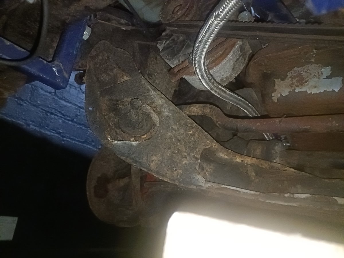

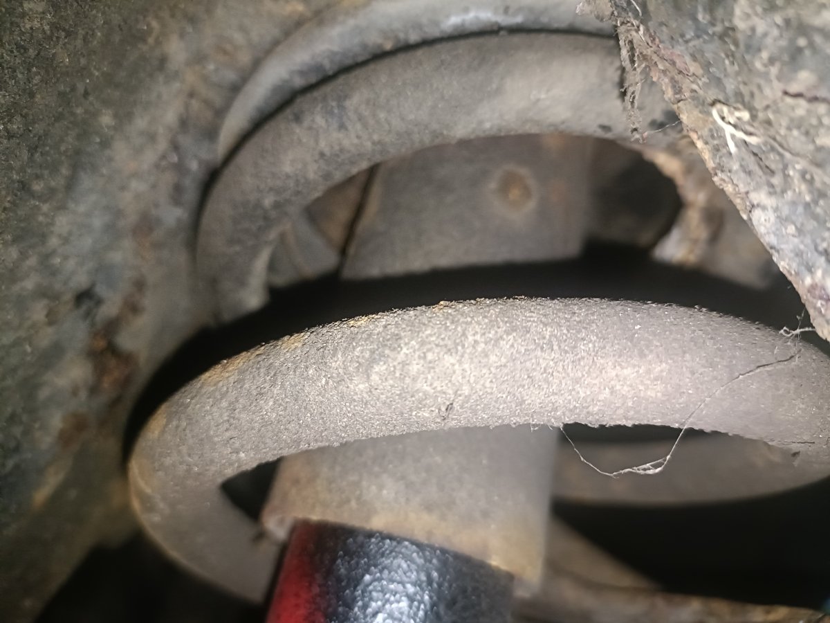

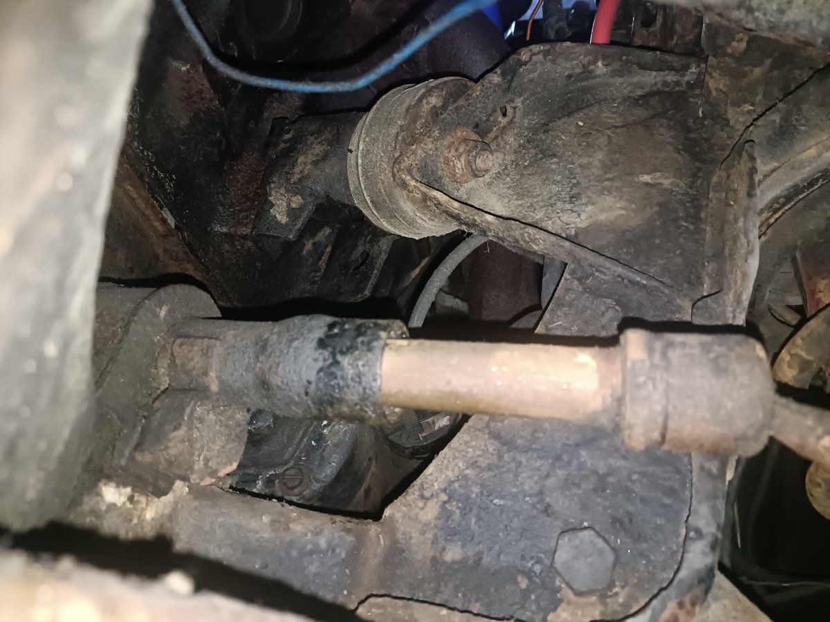

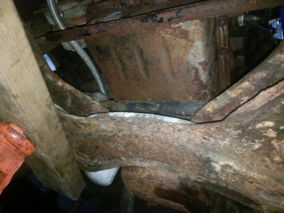

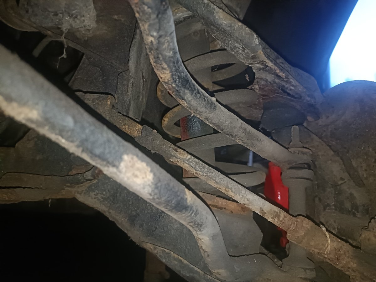

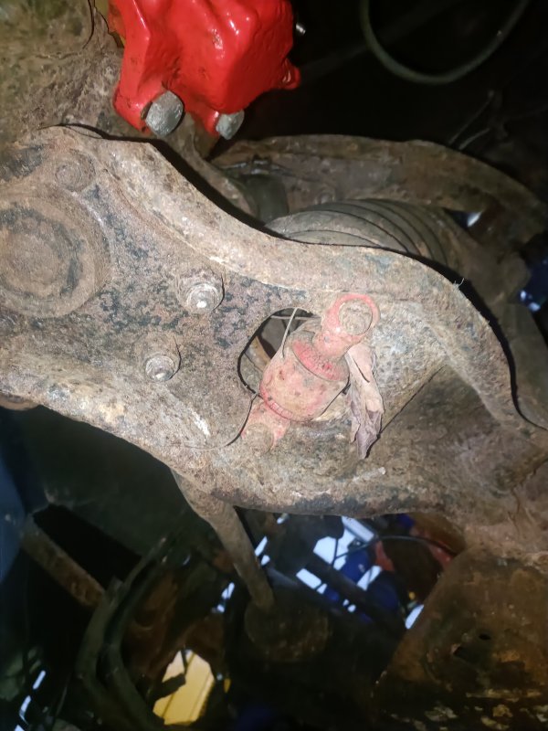

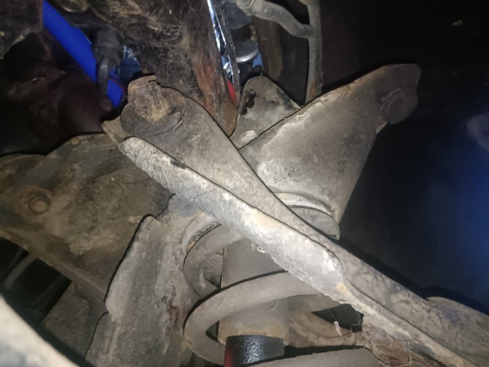

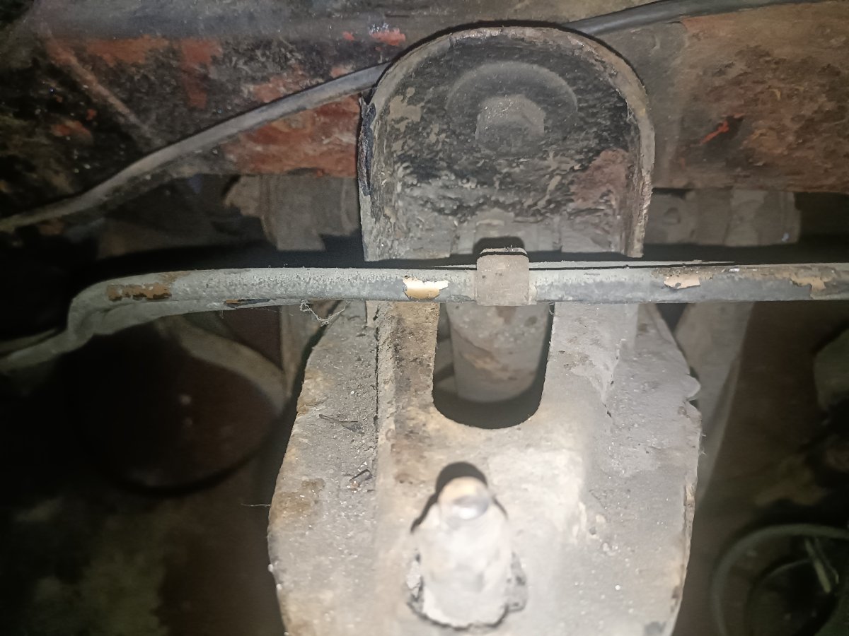

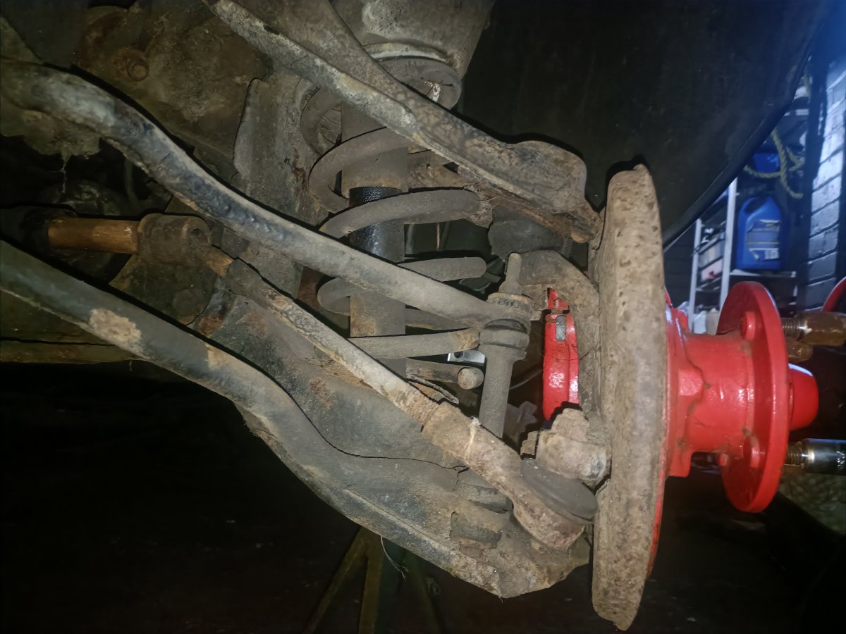

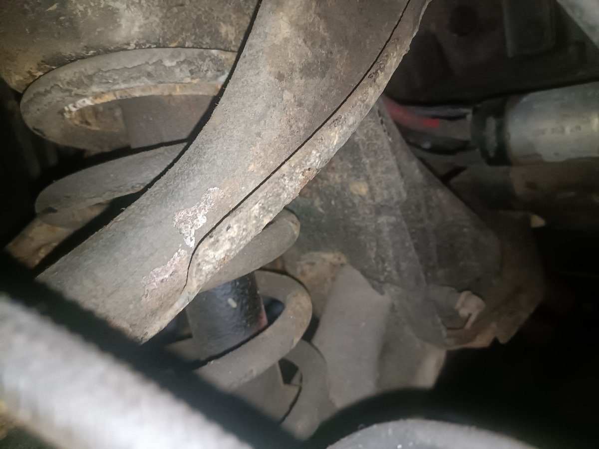

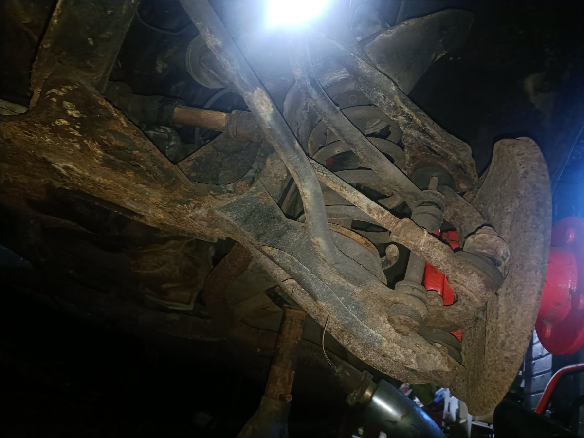

Daveyboy20 0 Posted January 28 Morning guys. I've raised the whole car up nice and high and I've taken multiple pictures of the front subframe/suspension so you can see it better 👍🏻 Quote Share this post Link to post Share on other sites
disco_monkey79 33 Posted January 28 On 1/22/2026 at 2:12 PM, sheffieldcortinacentre said: If you go much more than an inch you'll start scrubbing the inside of the front tyres due to increased negative camber . If memory serves 1 degree needs the lower arm mounting bolt moving inwards 5mm. Used to run 3 degrees negative on racer (cornering was great) but tyres would be bald on inside edge in circa 4k miles on road. So you have to get adjustable arms or redrill cradle, best supplier is rally design, most places don't understand Cortina running gear as escort is king, especially Burton power. Same will happen with rear I think there used to be wedge shaped spacers for the rear bearing mounts on sierra to correct camber. Most of all remember with state of roads it will soon drive you crazy dodging potholes, speed bumps etc. If you really must have the collapsed suspension look go air ride. Do you know the lb rating for standard V6 springs? Ignoring the potentially iffy ebay sellers (who proclaim suitable for all models regardless of engine type!!), the only ones I can find are 275lb at Burton Power. I was hoping to go firmer than standard, but it seems like it's these or nothing. I looked on Rally Design but they don;t seem to stock 'tina springs any more/ Thanks Quote Share this post Link to post Share on other sites
sheffieldcortinacentre 767 Posted January 28 (edited) As the ohc was the most common engine this is what everyone stocks nowadays. I'll check but seem to recall cologne V6 ones are 295, Essex V6 are 340 & small block ford V8 360. HD springs are an average 20lbin more. The works rally car had twin rear anti roll bars ( never tried this) was a fair but about rear end work . The racers retained std single but were 5 linked & turreted ( unlike UK cars. For improved handling bushes,anti roll bars & shockers are more important. Edited January 28 by sheffieldcortinacentre 1 Quote Share this post Link to post Share on other sites
disco_monkey79 33 Posted January 28 39 minutes ago, sheffieldcortinacentre said: As the ohc was the most common engine this is what everyone stocks nowadays. I'll check but seem to recall cologne V6 ones are 295, Essex V6 are 340 & small block ford V8 360. HD springs are an average 20lbin more. The works rally car had twin rear anti roll bars ( never tried this) was a fair but about rear end work . The racers retained std single but were 5 linked & turreted ( unlike UK cars. For improved handling bushes,anti roll bars & shockers are more important. Much obliged. If nothing else it would be handy to know what I am fitting! I have polyushed it and will be getting snazzy shocks. I am on the hunt for a chunkier ARBs but will have to go with standard for the time being. Thanks again. Quote Share this post Link to post Share on other sites
sheffieldcortinacentre 767 Posted January 28 The rollbars are hard to find nowadays. Quote Share this post Link to post Share on other sites
dgo 80 Posted January 29 White line used to sell uprated rear ARBs. Not sure whether they still do Quote Share this post Link to post Share on other sites
disco_monkey79 33 Posted January 29 3 hours ago, dgo said: White line used to sell uprated rear ARBs. Not sure whether they still do Thanks for the tip, but apparently not - they only have ARB bushes on their website. Quote Share this post Link to post Share on other sites
