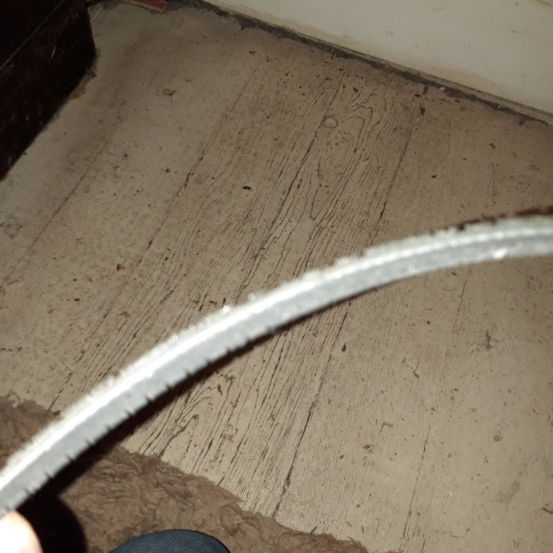

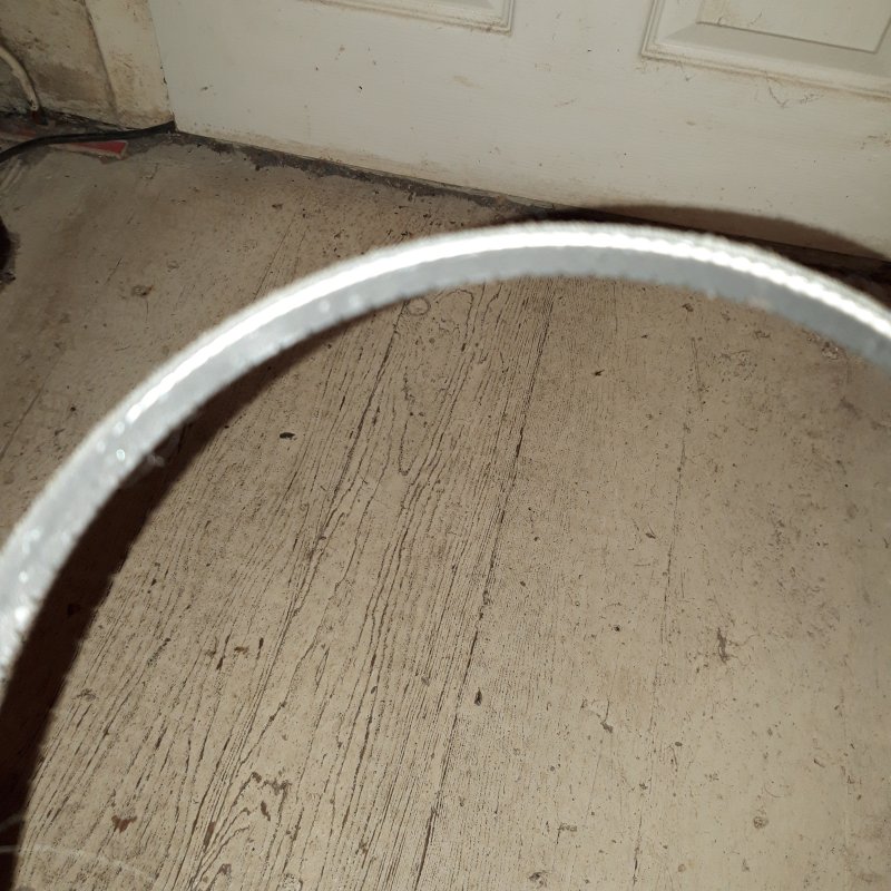

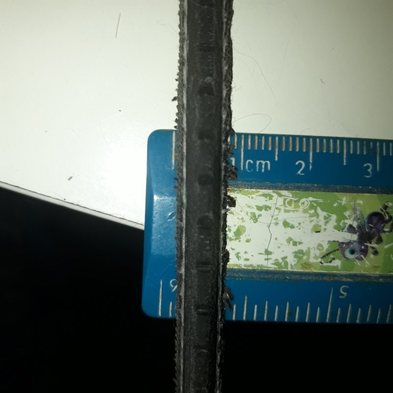

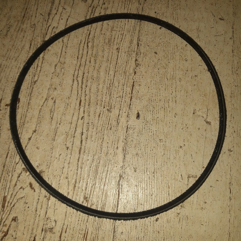

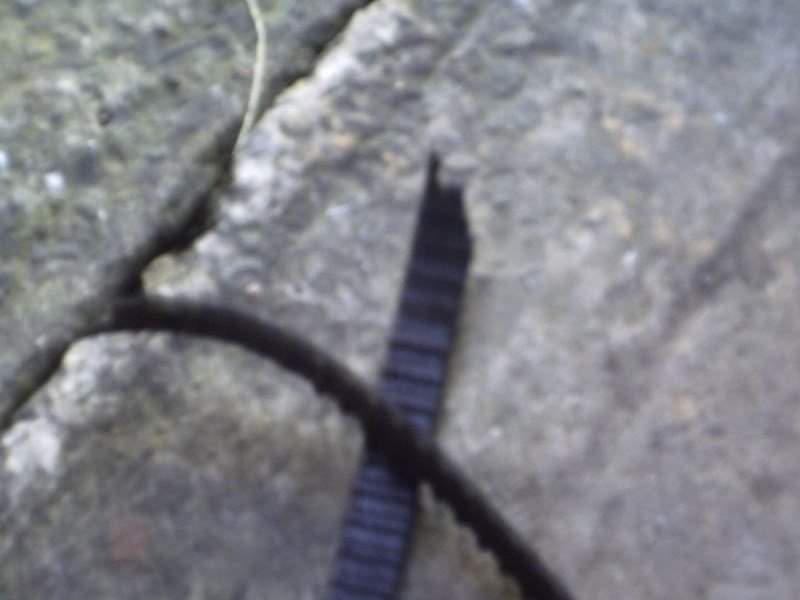

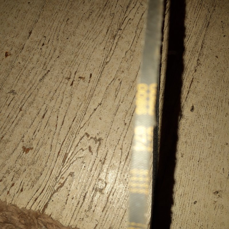

Beeper 85 Posted March 5 (edited) I think that I can safely say that all the rubber parts on my 76 (EDIT: it's a 75 not a 76, N reg not P reg doh!) F/L came from Dagenham! Void bushes were all a bit tired and replaced with FloFlex polly bushes. Tie bar rubbers were wafer thin sponge, resulting in a CLUNK at every speed bump, regardless of speed. I can't find a pic sorry. The timing belt stripped a few teeth, fortunately no engine damage done. Sorry again for the dodgey focus. Today, I fired up the engine and whilst revving it, the charge light started to dimly flicker but, it went out again at tickover. I noticed it giving a little squeel last time I was at the lockup and the fan belt looked a bit er,... thin, shall we say? Down to the stitching at parts. Getting a bit thin I think! Fortunately, I had a NOS fanbelt knocking around back from my Mk1 Fiesta days and it fitted perfectly. Apparently not much difference between a Valencia OHV and a SOHC, if anyone is looking for a cheaper alternative. In fact, when I searched and checked the part number (I have since chucked the motorcraft card cover away so don't ask), it came up as mk3/4/5 Cortina and mk1/2 Fiesta compatible. I've STILL not bled the brakes yet though! Edited March 6 by Beeper Quote Share this post Link to post Share on other sites
