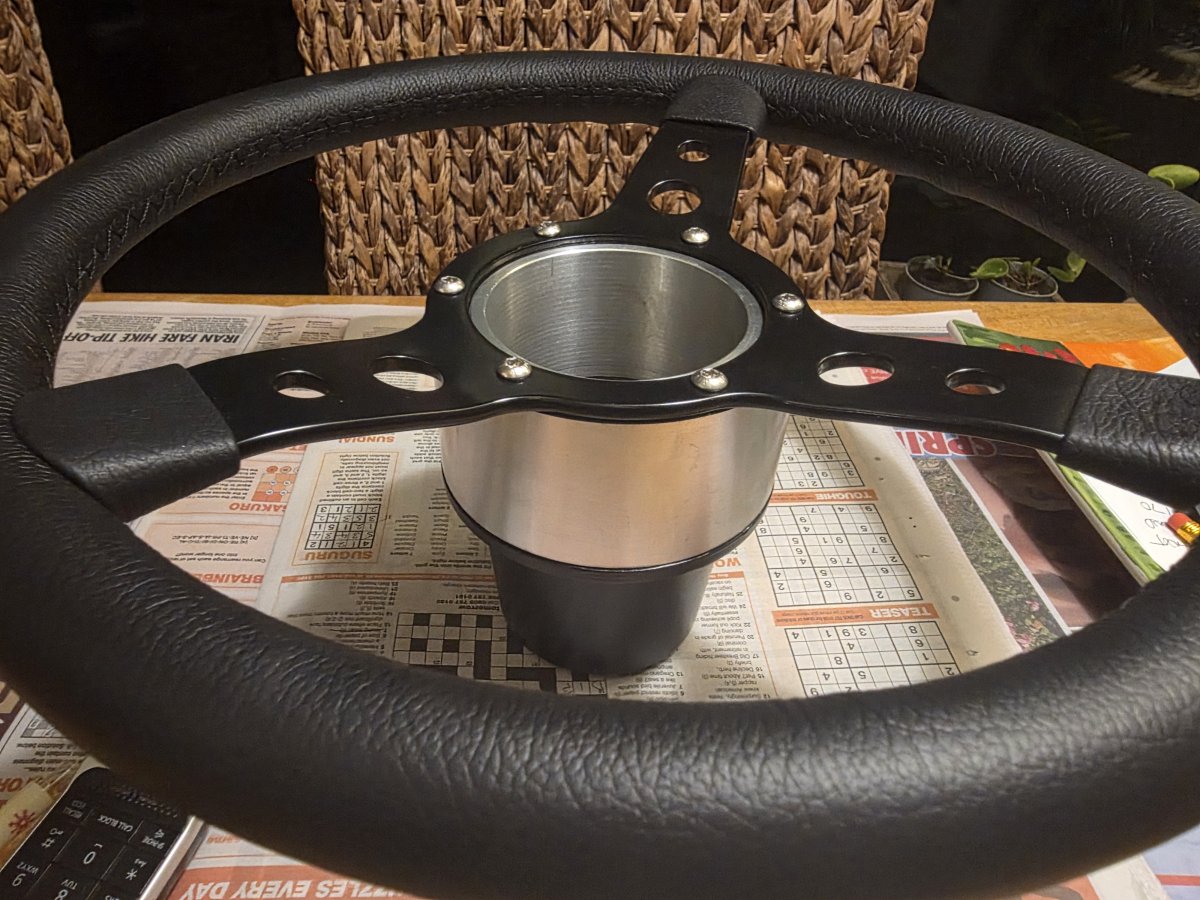

disco_monkey79 33 Posted March 30 On 3/25/2026 at 7:33 PM, Stuwindsurf said: Thanks, I just machined up a 50mm spacer for the steering wheel and now everything is perfect 👌 Very nice!! I like it. Share this post Link to post Share on other sites

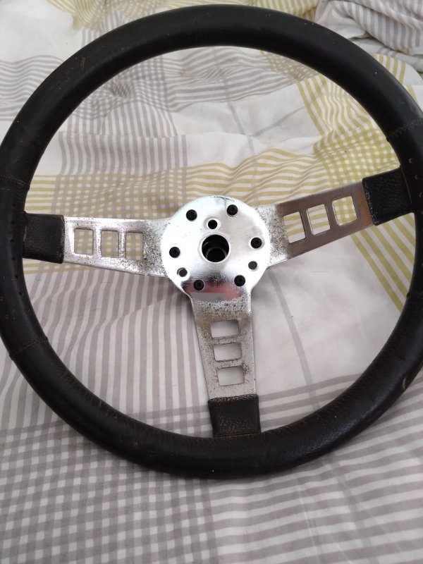

disco_monkey79 33 Posted April 1 Apologies if this is a thread hijack, but it's fairly related. This is the wheel I will (eventually) be fitting to mine. Weirdly the hole in the centre is too small for a socket, so I either have to fit the boss, and then attach the wheel, or leave a sacrificial socket permanently in there, and ignore the inevitable rattle. Any thoughts on how I can neatly increase the centre hole? A hole saw is out, as the centre hole is way bigger than the hole saw's guiding bit. And the diameter of the wheel is too much for my lathe bed. I could drill a long series of small holes, but that will take ages and not be very neat. Yes, it will (probably) ultimately be hidden by a centre piece, but I would still prefer to do it neatly than just hack at it. Thanks! Share this post Link to post Share on other sites
markymarkthree 178 Posted April 1 44 minutes ago, disco_monkey79 said: Apologies if this is a thread hijack, but it's fairly related. This is the wheel I will (eventually) be fitting to mine. Weirdly the hole in the centre is too small for a socket, so I either have to fit the boss, and then attach the wheel, or leave a sacrificial socket permanently in there, and ignore the inevitable rattle. Any thoughts on how I can neatly increase the centre hole? A hole saw is out, as the centre hole is way bigger than the hole saw's guiding bit. And the diameter of the wheel is too much for my lathe bed. I could drill a long series of small holes, but that will take ages and not be very neat. Yes, it will (probably) ultimately be hidden by a centre piece, but I would still prefer to do it neatly than just hack at it. Thanks! Would a good ole box spanner fit ? Share this post Link to post Share on other sites
disco_monkey79 33 Posted April 1 3 minutes ago, markymarkthree said: Would a good ole box spanner fit ? Hmmm, excellent point. Logic suggests there has to be a way to do it in place. I will pop round my Dad's and see what I can pinch! Share this post Link to post Share on other sites
dgo 80 Posted April 1 How about using a stepped drill bit? I've seen those up to a couple of inches in diameter. Share this post Link to post Share on other sites
John Mack 342 Posted April 1 1 hour ago, disco_monkey79 said: Any thoughts on how I can neatly increase the centre hole? 6Pcs 4mm-32mm Spiral Step Cone Drill Bit Titanium Nitride Coat Metal Hole Cutter | eBay UK Share this post Link to post Share on other sites
disco_monkey79 33 Posted April 1 Thanks both - I will give one of those a go if the box spanner is still too big. Share this post Link to post Share on other sites
sheffieldcortinacentre 772 Posted April 1 Cone drill. Share this post Link to post Share on other sites
