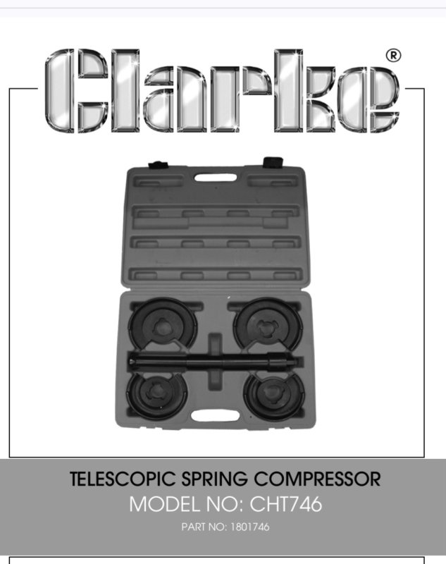

Essy 0 Posted March 20 Hi. Thanks for your reply. Here is a picture of the spring compressor, I know it's not the right one as I need the type that fits into the shock absorber fixings. I can't get one of those for love nor money. Quote Share this post Link to post Share on other sites
sheffieldcortinacentre 765 Posted March 20 Any of the external ones are extremely dangerous on front springs as they are curved when fitting ( there will be loads saying they've done it loads of times). The other way to do it with out the one that fits in place of shocker is to put a trolley jack under the arm & remove the inner lower bolt then lower complete arm.also remove top shocker bolt & loosen lower but leave in place it will help limit the firing range of spring. Quote Share this post Link to post Share on other sites
Essy 0 Posted March 20 Thanks for your advice. I was hoping to get a tool that works. As I am retired from the motor trade and remember wrestling with these in the 70s and 80s now approaching 70 my days of struggling with Jack's and leavers are long gone. Trying to find the right tool for these old cars is nigh impossible these days. Quote Share this post Link to post Share on other sites
