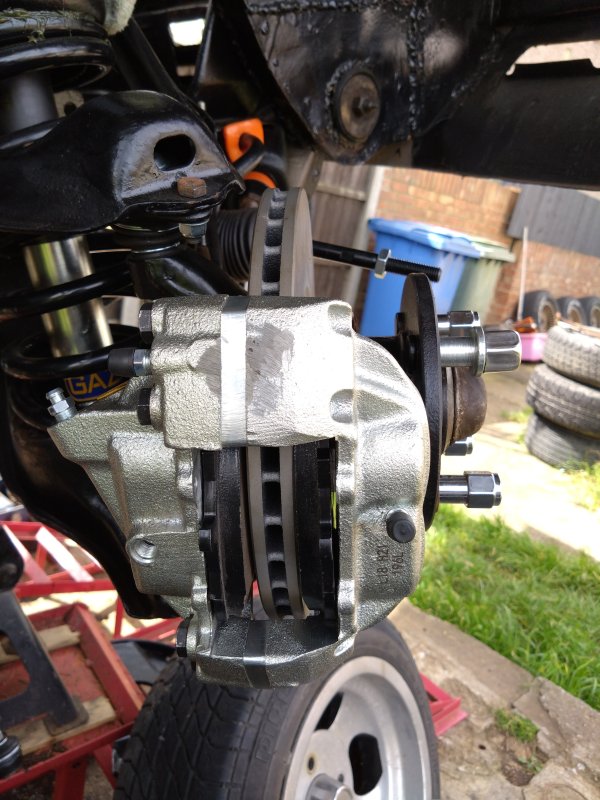

Just putting this here for info purposes. I got a pair of recon/remanufacturedAustin Princess 4-pot calipers, to hopefully give a bit more anchoring assistance.
With Capri vented discs I found that I needed 7.5mm spacers between the caliper and the upright/spindle bearer, to get the disc centered in the caliper.

Did you use the original flexible hoses ?
What pads did you use ? I have heard using EBC Green or Red stuff is a good option.
I have bought braided hoses - the original ones were junk, so took the chance to upgrade. But I haven't fitted them yet - this was more to make sure everything would bolt together, and would my 13" slotmag still fit (yes, phew).
They came with brake pads. I don't think they are anything particularly exciting, but I will bear in mind about EBC.
I will add detail as I actually get things hooked up and functioning.
