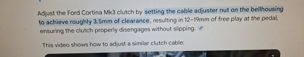

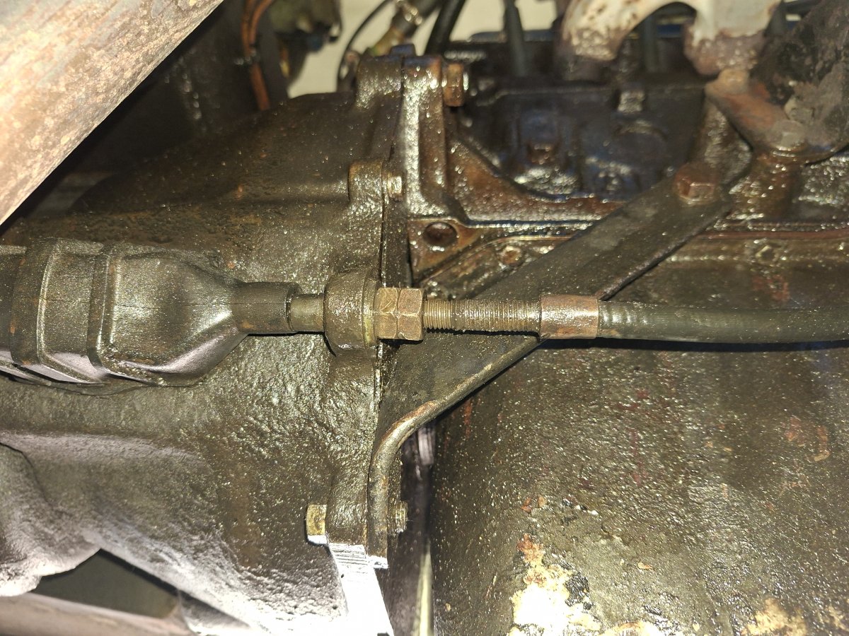

the-urban-spaceman 1 Posted April 30 Baffled here. Got a mk3 Cortina with a 5 speed P100 gearbox fitted. So no adjustment pedal end. When I adjust cable to with the 3.5mm clearance as in Haynes manual it's closes up when pedal pressed and the pedal height goes up? Any ideas anyone? Getting sticky engaging first gear. Quote Share this post Link to post Share on other sites

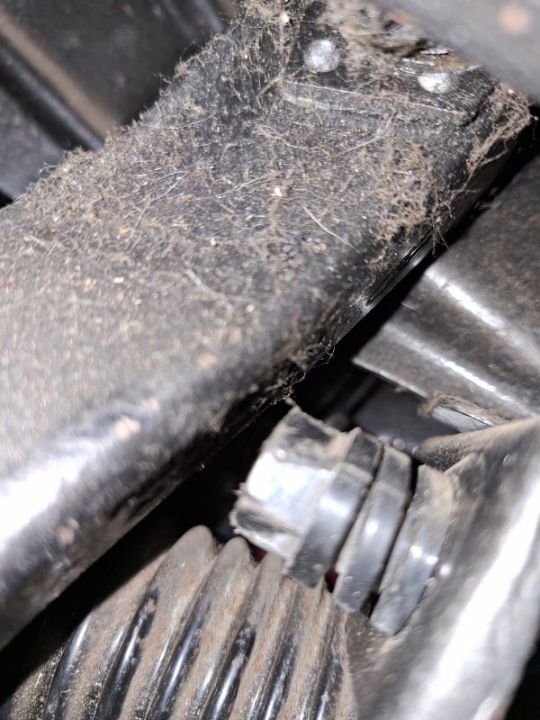

sheffieldcortinacentre 767 Posted April 30 If it's a petrol P100 then it's same box as the 2.0 4spd & shouldn't give any problems, if it's from a diesel that's have the petrol bell housing fitted that will be problem as it's longer & the shorter petrol one will be cocking everything up. Has the clutch pedal got the spring attached below the pivot point? If this is missing/broken then it will make the pedal sit high as it's supposed to keep a light pressure on it to tack the slack up. Hard to explain with out pics. Quote Share this post Link to post Share on other sites
the-urban-spaceman 1 Posted May 1 Not sure. Bought it 25 years ago for 30 quid out the local rag. Same dimensions as 2.0 4 speed. Will double check pedals and get some photos. Thanks Quote Share this post Link to post Share on other sites
the-urban-spaceman 1 Posted May 1 Think sussed it. Didn't realise was a stop on pedal. Need to wind in i think. This is oil I used. Quote Share this post Link to post Share on other sites

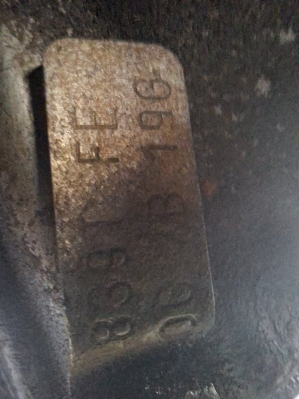

the-urban-spaceman 1 Posted May 1 This is gearbox number is it a type 9? Quote Share this post Link to post Share on other sites
markymarkthree 178 Posted May 1 32 minutes ago, the-urban-spaceman said: This is gearbox number is it a type 9? Cant read that. If the gear stick is held in place by 3 bolts, i would say it is a type 9. Quote Share this post Link to post Share on other sites
the-urban-spaceman 1 Posted May 1 It is. Yes. Thank you. Quote Share this post Link to post Share on other sites
sheffieldcortinacentre 767 Posted May 1 (edited) 7 hours ago, the-urban-spaceman said: Think sussed it. Didn't realise was a stop on pedal. Need to wind in i think. This is oil I used. Semi synthetic is better . Edited May 1 by sheffieldcortinacentre Quote Share this post Link to post Share on other sites
sheffieldcortinacentre 767 Posted May 1 2 hours ago, markymarkthree said: Cant read that. If the gear stick is held in place by 3 bolts, i would say it is a type 9. Yep that's type 9 style gear stick. If it had been a diesel box it would need input shaft shortening & 1st gear is useless in a petrol. Quote Share this post Link to post Share on other sites
the-urban-spaceman 1 Posted May 2 (edited) thanks all. just realised, that oil picture i posted was used for something else. I did use Castrol Syntrax Universal – EP Part Synthetic Manual Transmission Fluid – API GL3/4/5 - SAE 75W/90. so all good. Also missed the note in manual saying assistant must hold clutch pedal up to stop (doh!!!), hence can't get clearance. Had a play with it yesterday and seems a lot better. Edited May 3 by the-urban-spaceman Quote Share this post Link to post Share on other sites
